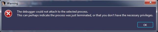

Basic analysis using Procmon shows that the malware relaunches itself as a child process, which is where most of the action takes place. However, all attempts to attach to the child process with a debugger to get a closer fail with the following error:

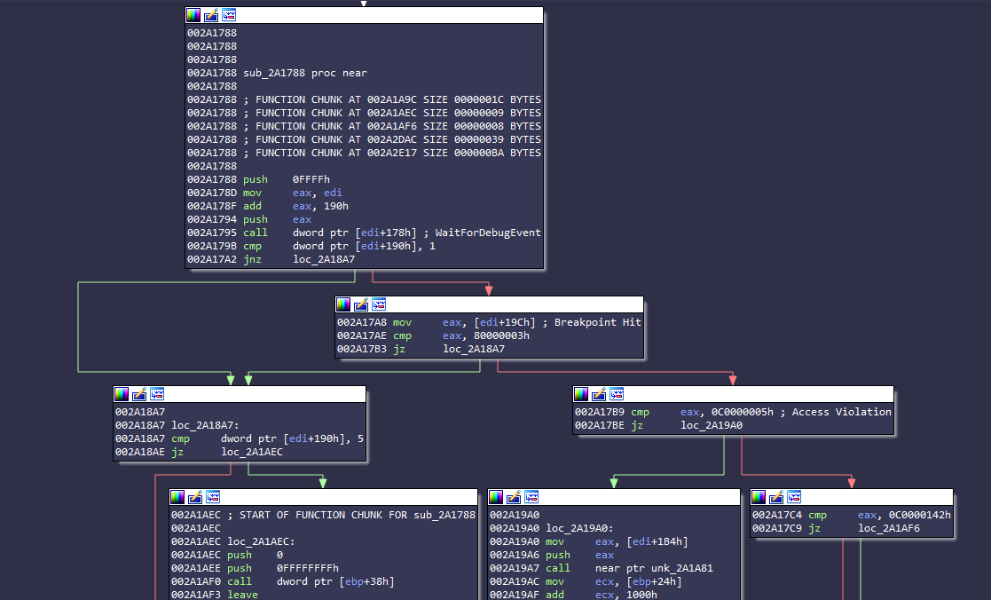

The explanation resides in the flags passed to CreateProcess by the parent. When the malware relaunches itself as a child process it does so with the DEBUG_ONLY_THIS_PROCESS flag specified. This causes the parent to act as a debugger to the child, which prevents analysts from attaching their own debugger to get a closer look at what it’s doing.
Then, the parent walks through the child’s execution using the WaitForDebugEvent and ContinueDebugEvent API calls for creating a co-dependent relationship between the parent and the child with no room for an additional debugger:

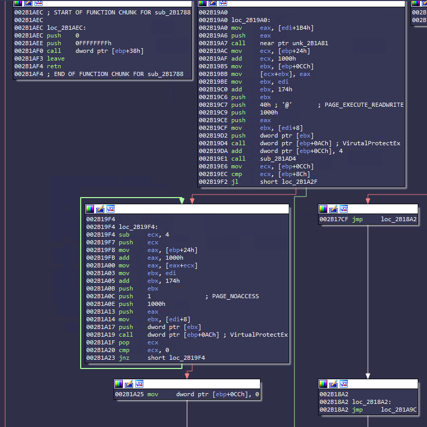

After launching the child with the parent set to debug it, the child calls VirtualProtectEx with the NO_ACCESS flag set on its own memory space. This means that any attempt to read, write or execute in this space will result in an access violation exception.
However, because the exception gets passed to the parent, which is debugging it, the parent handles the exception by calling VirtualProtectEx again on the section with the flags set to EXECUTE_READWRITE to temporarily allow execution. After this, it sets the memory back to NO_ACCESS again to prevent dumping:

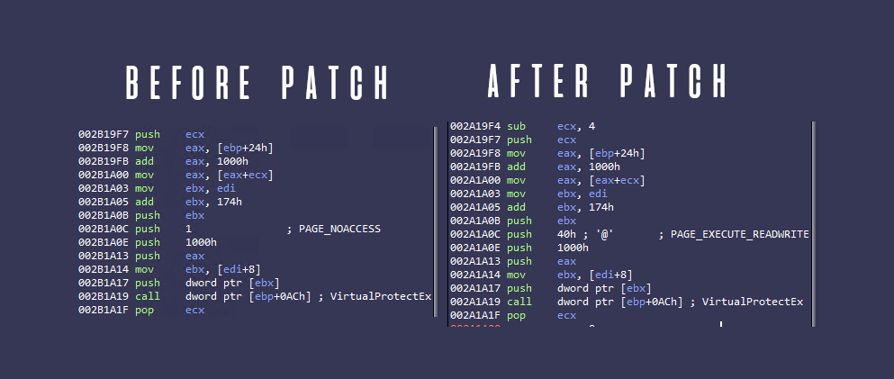

Luckily, we can get around this by using IDA to patch the arguments passed to VirtualProtectEx changing the the NO_ACCESS flag to a EXECUTE_READWRITE flag allowing for a complete memory dump of the child:

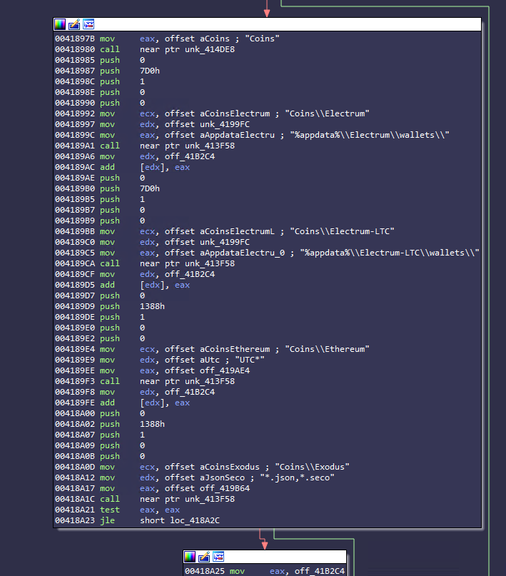

Equipped with the new memory dump, it becomes much easier to get a handle on what the malware is doing:

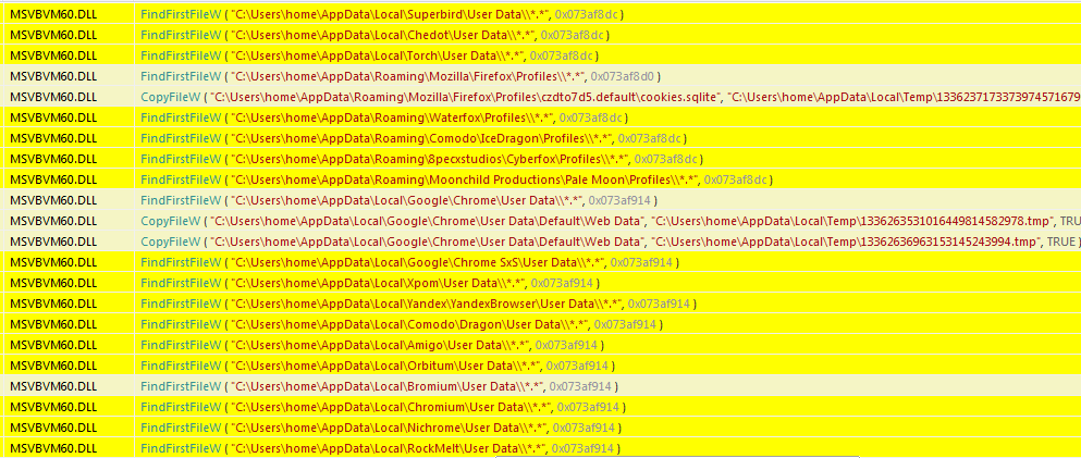

As you can see, the malware is looking to steal crypto wallets from infected endpoints. Additionally, by tracing API calls, we find that it is searching for to saved logins and cookies from a number of browsers including Bromium Secure Browser:
