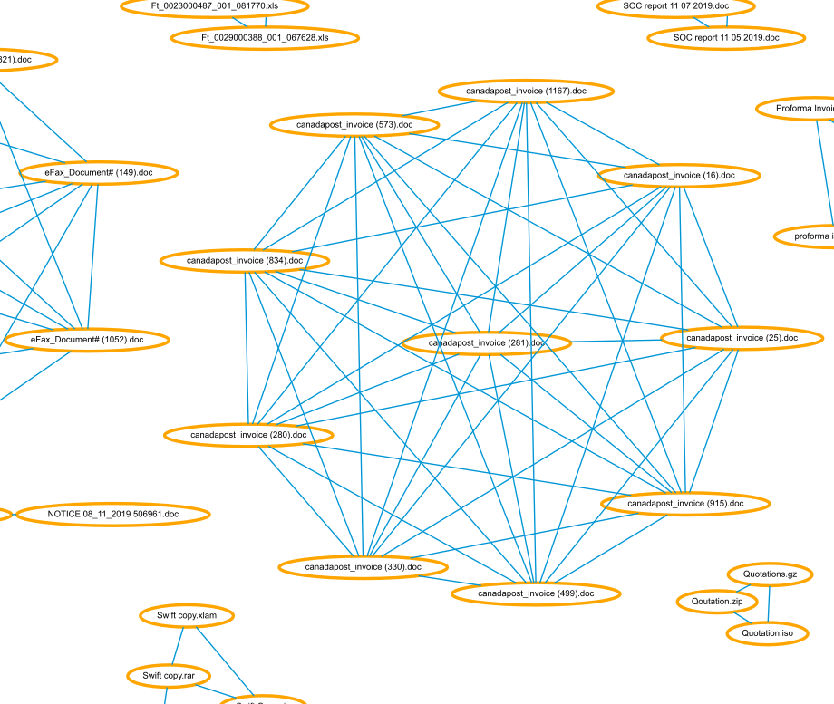

Introducing graph_similar_strings.py
To demonstrate how to analyse email logs using string metrics and visualise the results, we’ve published a Python script called graph_similar_strings.py.[1] It reads a list of strings and generates link charts that cluster similar strings together based on a chosen string metric and distance threshold.
The script can be used to create a dashboard to maintain situational awareness of potentially malicious email campaigns by clustering similar strings together, such as filenames and subject lines. To use the script, supply a text file containing a list of strings. By default, the script outputs DOT files that can be exported as images using NetworkX and Graphviz graph generation and visualisation libraries.[9][10] If Graphviz is in your PATH, the script can export to SVG (recommended) or PNG images for you. We recommend adjusting the distance thresholds to your environment by running the script against a sample dataset from your network first.
Figure 1 – Attachment name similarity link chart generated with graph_similar_strings.py. Similar filenames are clustered together.

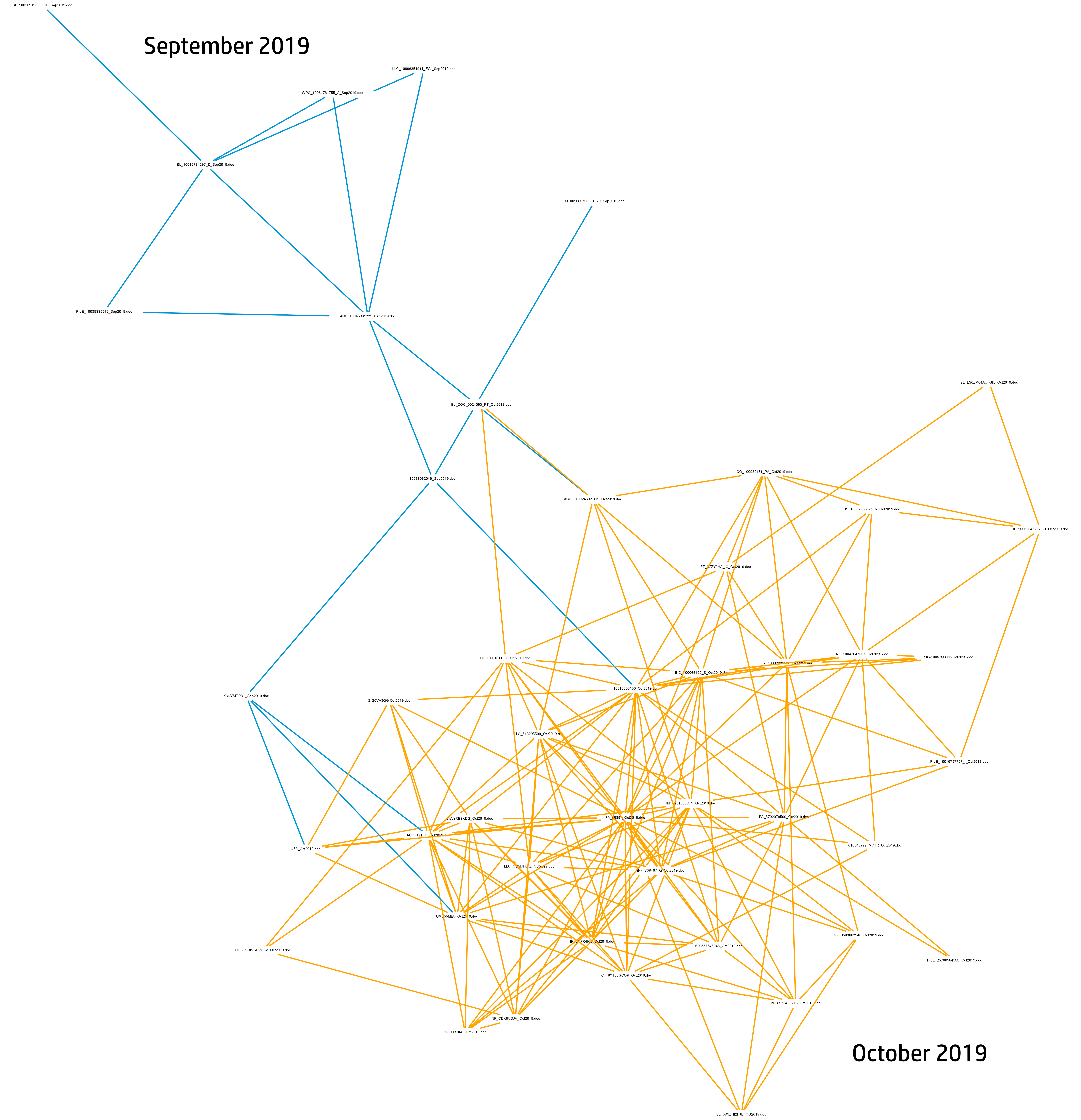

Practical Example – Tracking Malware Campaigns using Similar Filenames
Figures 2 to 4 are filename similarity link charts that show the development of a subset of Emotet malspam campaign activity over three months (September to November 2019). Each node is a unique filename that is connected by edges to other filenames that met the distance threshold. By regularly generating link charts, you can understand the scale and nature of malware campaigns at a glance and gain better situational awareness of email-borne threats as they develop.
Figure 2 – Filename similarity link chart for an Emotet malspam campaign in September 2019 (month 1).
Figure 3 – Filename similarity link chart for an Emotet malspam campaign in October 2019 (month 2).
Figure 4 – Filename similarity link chart for an Emotet malspam campaign in November 2019 (month 3).
