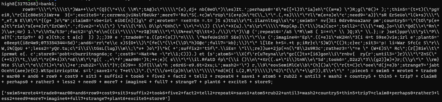

First, we look at all extracts from the regular expressions (regex) because this is usually the reason why the decoder breaks. To do so, we add print statements before and after each regex evaluation starting from the bottom of the script. The following image shows our first check.
Figure 1 – Print statements around regular expression evaluations.

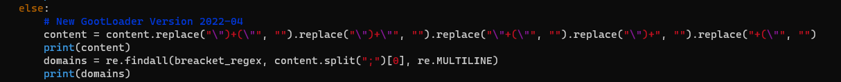

Based on the output we try to figure out the position where the script fails to decode the new GootLoader version. In this case, we get an empty content output and therefore the script failed earlier in the process. In Figure 2, above the regex evaluation, we you can see an additional print statement to debug the script:
Figure 2 – Printing the content and the longest match of the regex.
Running the script again leads to another empty output. So further debugging is required. Again, we add two print statements around the next regex evaluation, which looks as follows:

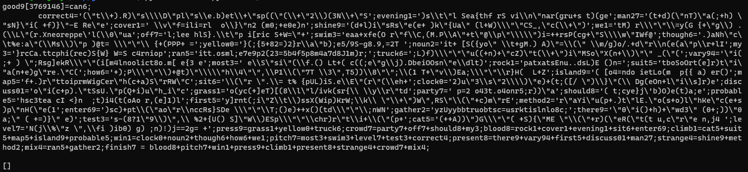

At this point we finally get an output from our debug print statements. This tells us that we found the position where the script fails to decode the new version of the malware.
Figure 4 – Printed script content of the new GootLoader version.

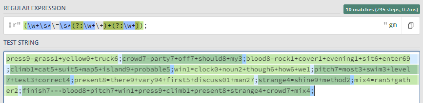

The regex result for this evaluation should lead to a list of variables concatenated with plus signs. This list is used by GootLoader to rearrange the code into the right order and then later on execute it using the eval function. To decode the script and extract the domains and URLs we need to do the same and bring the code into the correct order. With this version adjustment, GootLoader no longer uses just one statement to rearrange the code, but several interdependent ones. To fix the script we need to make two edits. First, we need to adjust the regex pattern so that it matches the new statements. Second, we need to add logic to merge the code. With the help of regex101.com we can adjust and fix the regex pattern.
Figure 6 – Extracting the statements using regex.
The idea is to extract all the statements used for the code arrangement.
Figure 7 – Definition of regex pattern to extract the statements.

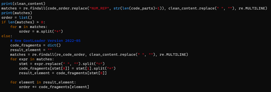

Each statement can be split into the variable and the expression. To keep track of the variables we create a dictionary which uses the variables as keys and the expressions as values. The last statement is the main statement used to join the code. For this statement we substitute the expression based on the values in our dictionary and get the final expression consisting of variables that refer to code fragments. The adjusted code sequence looks like this:
Figure 8 – Modified code sequence to decode the new GootLoader version.

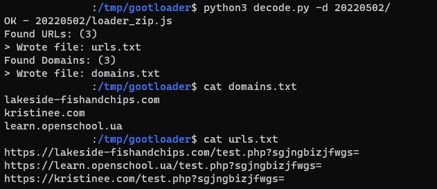

To keep the script still compatible for older GootLoader versions, we add an If statement. If we do not get regex matches for the simple statement, we use the code which evaluates compound statements. Finally, we remove the print statements which we inserted for debugging and run the repaired script to get the following output:
Figure 9 – GootLoader decoding script output.
